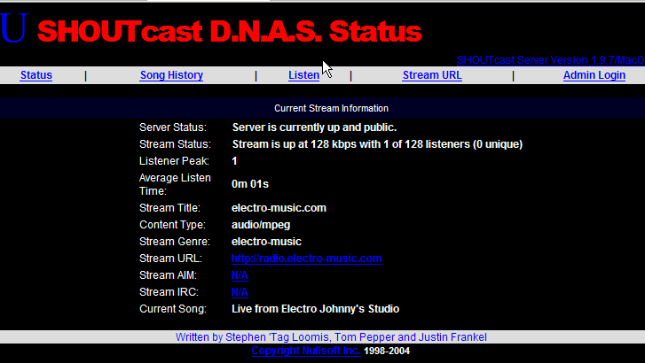

    Note that for an sc_trans connection you can not directly use the sc_trans port to check your setup. Instead for the sc_trans test port (9878) you will need to monitor port 8054. And for the sc_trans live port you'd use port 8052, or the main port 8050.
    Please use the test port for testing!
    To test or troubleshoot your connection the easiest thing to do is to set the connection up as good as you can, and then at your failure point go to the Chat Room to ask for help.
    There are also some things you can try without help from others. There is a port overview page which has a lot of detail once you know what to look for.
    • The left column, status, shows a lit light for a port that has a client connection and a dull one otherwise. When it is lit you are, or at least something is, connected to that server. When it is not lit you either nothing is connected or your stream title or song title has some non ASCII characters in it, or one of those bits is too long too be handled by the server - keep it ASCII and short, at least while testing.
    • The listen column shows a speaker symbol you can click on to listen to the audio which currently is on that port [this currently does not work for the Chrome browser] - the speaker will be lit up yellow when there actually is audio, and dull otherwise.
    • The channel column will show the stream title that you have set in your streaming client (prefixed with electro-music.com).
    • When you hover your mouse pointer over the light bulb in the leftmost column a popup window will show with some additional info. Check your bitrate here, for switched ports this must be set to 128 (kbps).
    You can check out your server page http://radio.electro-music.com:8070 (use your port instead of 8070) as well and you should see something like this:
