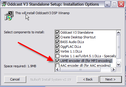

    Run the installer.
    After you accept the license agreement, be sure to click that you wish to install the LAME encoder so you can stream MP3 file format.
    You will be directed to a web page for the Lame encoder. I suggest you download the latest non-alpha or non-beta "bundle" and install it in your Program Files directory which is usually on the C: drive.
    After Edcast is finished installing, copy the file lame_enc.dll from your Lame installation to the directory where Edcast was installed.

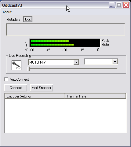

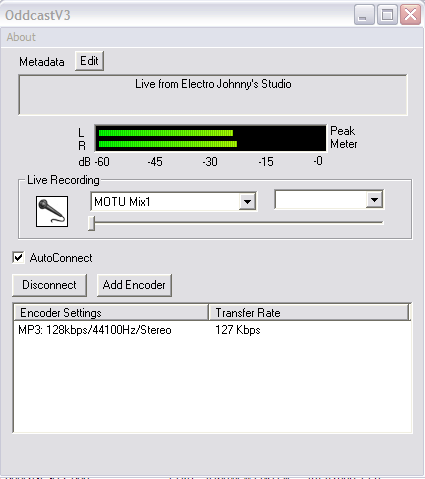

    Now you are ready to test out your Edcast installation. Click on the Edcast icon that is on your desktop or run the standalone exe file in the Edcast directory.
    You will see a screen like this:
    Select the audio device you want to use for your stream. It may be different from the MOTU device shown on my example. You can see the meters operate if you have a signal. Sometimes when the device is configured incorrectly or there is no input to the device you'll see the meters at full scale. Ignore the Live Recording button and the slider unless you have a standard Windows sound card with DXI drivers.
    When the VU meters do not show any signal you may have to click in them to make them work.
    Then click on the Add Encoder button and a line will appear in the text area below the Encoder Settings heading. Double click on that new line and the configuration windo will appear, looking like this:

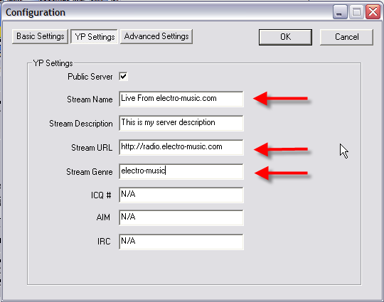

    Now click on the YP Settings Tab at the top of the configuration window. You'll see this:
    You can use a different stream name if you wish, to describe your event.

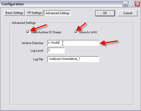

    Next, click on the Advanced Settings tab:
    This is optional, but if you check of the two check boxes and include a directory you will be able to make a simultaneous recording of your stream. If you don't click Save as WAV it will save the MP3 file.
    Next, click OK and return to the main Edcast window. Click on the Connect button and see if you connect to the server. If it keeps trying and not getting through, then recheck your settings making sure you have the port and password correct. There is a chance that the http://radio.electro-music.com server is down. To check, use this URL http://radio.electro-music.com:8070 but replace 8070 by your port number. You should see the Shoutcast D.N.A.S. screen.
    Almost finished now...
    If everything is working, check the AutoConnect box. This will automatically reconnect if something causes a disconnect during your stream.

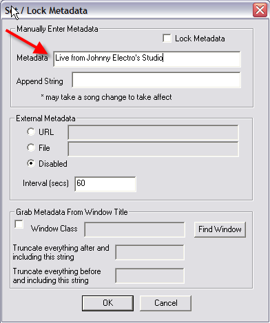

    Finally, Click on the Edit button next to the word Metadata near the top of the window. This is where you put in the title of your performance. Put that in the Metadata field - leave the rest of the stuff alone.
    You can edit the metadata anytime you want while you are streaming. If you are streaming a concert you may want to make the metadata identify who is performing.
    Alternatively you can use a file to specify your meta data.
    The location of the stream title metadata is in the file C:\Program Files\edcast\streamtitle.txt
    Please put something about your content in this file. I put a shortcut to that file on my desktop.
    When all is working well, you will see something like this:

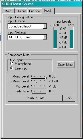

    • Click on the Input tab and ensure that the correct Input Device is selected, in our case use Soundcard - NOT Winamp. This is because we will use the soundcard for our live broadcasts.
    (It isn't necessary to use the soundcard mixer in the bottom part of this configuration window. This works only for commercial PC sound cards. If you have a professional audio interface, like a Firewire MOTU 828 or something, that mixer section won't even work.)

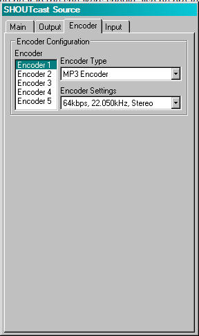

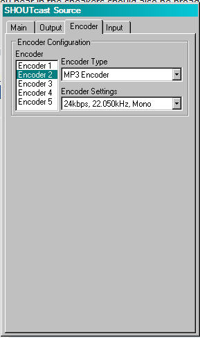

    Note: on the windows below, we set up two outputs and two encoders - one for 128 kbps and one for 24 kbps:
    • Click on the Encoder tab, select Encoder 1 on the left, and select the bitrate options 128 kbps - stereo.
    • Click on the Encoder tab again, select Encoder 2 on the left, and select the bitrate options 44.1 kbps - stereo.

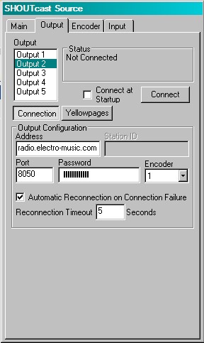

    • Click on the Output tab, then select Output 1 on the left.
    • Click on the Connection button to bring up the settings for the SHOUTcast DNAS you will be connecting to. Enter the URL radio.electro-music.com under Address. Use the Port number, broadcasting password set on the server, and select 2 under the Encoder pulldown menu. (Yes, that's right - Output 1 uses Encoder 2, and Output 2 uses Encoder 1. It's a quirk with Winamp - sorry.) Enter the first port number and password given to you by a stream operator.

    • Click again on the Output tab, then select Output 2 on the left and repeat the above steps for the Output 2. Use the 2nd port number you were given, and use Encoder 1 (yes, Output 1 uses encoder 2). Be sure to change the Yellowpages fields as well.
